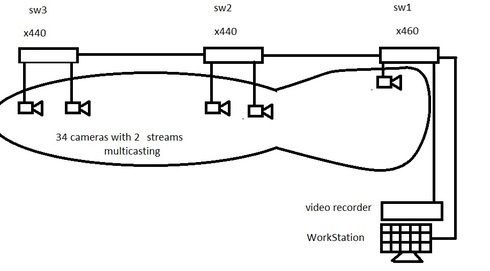

Hello i have trouble with seting up multicasting in my X440-X460 switches. I can ping every device in network, but Video is not showing under my WorkStation or isnt recorded. I have run wireshark on my Workstation sniffing for multicast trafic but no trafic was found. How to diagnose this situation. (Windows firewal is diabled)
Network topology

Network topology

Problem solved! Thanks! Any switch hasn't configured IP so i think there wasn't anyone to send query. So i run under switch1 this command and everything works like charm!
configure vlan "v3-CCTV" ipaddress 192.168.3.254 255.255.255.0

Couple of observations and questions. If you have igmp snooping enabled the switch will prune back all the mcast streams till it sees a join from your pc.
Each Camera should also have it's own ip and mcast address. If you do a show igmp snoop detail on the switch you should see all the mcast senders (cameras) and what mcast address they are using. This would also tell you if the camera was actually transmitting out a mcast stream.
Your PC would need to do a join for each of the cameras you wish to record and watch.
Each of those ports that are hooked up to a camera should be receiving xxx bandwidth all the time if the camera is working.
You could also create a mirror port and add one of the camera's ports or the vlan and do your sniff from that port to see what the camera's are sending out.

Hi Piotr,
Just to confirm, your PC isn't receiving the 239.255.255.250 stream?
What is sending this stream out? Is it in the same VLAN as your PC?
