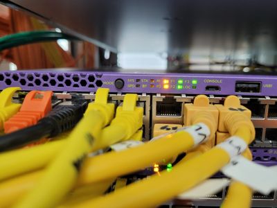

a customer has some issues with a stack consisting of two X465-48T Switches where we received false notifications about power supply failures. The stack is running on 31.7.1-Patch1-17, I checked the latest patches and they have no such bugs in their resolved issues list:

Additionally, the output of show power detail is suspicious considering the stack is running fine.
1. The switch only has 2 slots but the output suggests that there are many more.
2. The PSU that are recognized are shown as "powered off" (The switch LEDs also suggest that)
A reseat of the redundant PSUs changed nothing.
