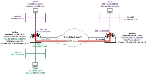

Ok so I have simplified the diagram:
acc467834afe497d8fe92d62ed2a6118_RackMultipart20160629-70633-1ctuf8k-vxlan2_inline.jpg
Summary:
User1
Vlan 100
Default Gateway = 192.168.100.1
User2
Vlan 100
User3
Vlan 10
Default Gateway = 192.168.10.211
Ping results:
User1
Ping to Default Gateway (192.168.100.1) = Successful
Ping to Vlan 10 Router Interface (192.168.10.211) = Successful
Ping to User 2 = Successful
Ping to User 3 = Successful
User2
Ping to User 1 = Successful
Ping to User 3 = Fail
User3
Ping to Default Gateway (192.168.10.211) = Successful
Ping to Vlan 100 Router Interface (192.168.100.1) = Successful
Ping to User 2 = Fail
As previously mentioned when I move the routing function from the SSA to a external router (routing between vlan 10 and 100) all devices can ping all other devices.
I would have presumed that if User1 can access vlan 10 devices then and other device in vlan 100 with the same gateway would also be able to get to vlan 10.
I would have presumed that the SSA acts like a VXLAN L3 gateway when you terminate a tunnel on it.
This is my firt time in the ring the VXLAN so please correct me if I am wrong.
I will test the same setup with a GRE tunnel and report back.
Thx
Andre
Erik_Auerswald
Contributor II
Hi Andre,
what you are describing seems related to the usual case with VXLAN Layer 2 gateway functionality, where you need an external router to route between VXLANs.
Your setup is not the usual VXLAN data center use case, but more of a traditional Layer 2 point-to-point tunnel setup.
I would expect connectivity between 192.168.100.111 and 192.168.10.10 if both VLANs are routed on SSA One and both PCs use SSA One as default gateway. It would be interesting to know if adding the VXLAN tunnel breaks this.
The case for connectivity between 192.168.100.112 and 192.168.10.10 is unusual for VXLAN setups, because SSA One would need to decapsulate the VXLAN packet and then run the resulting frame through VLAN/SVI routing. The usual method is to route to the target VXLAN on the encapsulating switch, if you have a Layer 3 VXLAN gateway.
Does your setup work without an external router if you use a GRE L2 tunnel between the SSAs?
