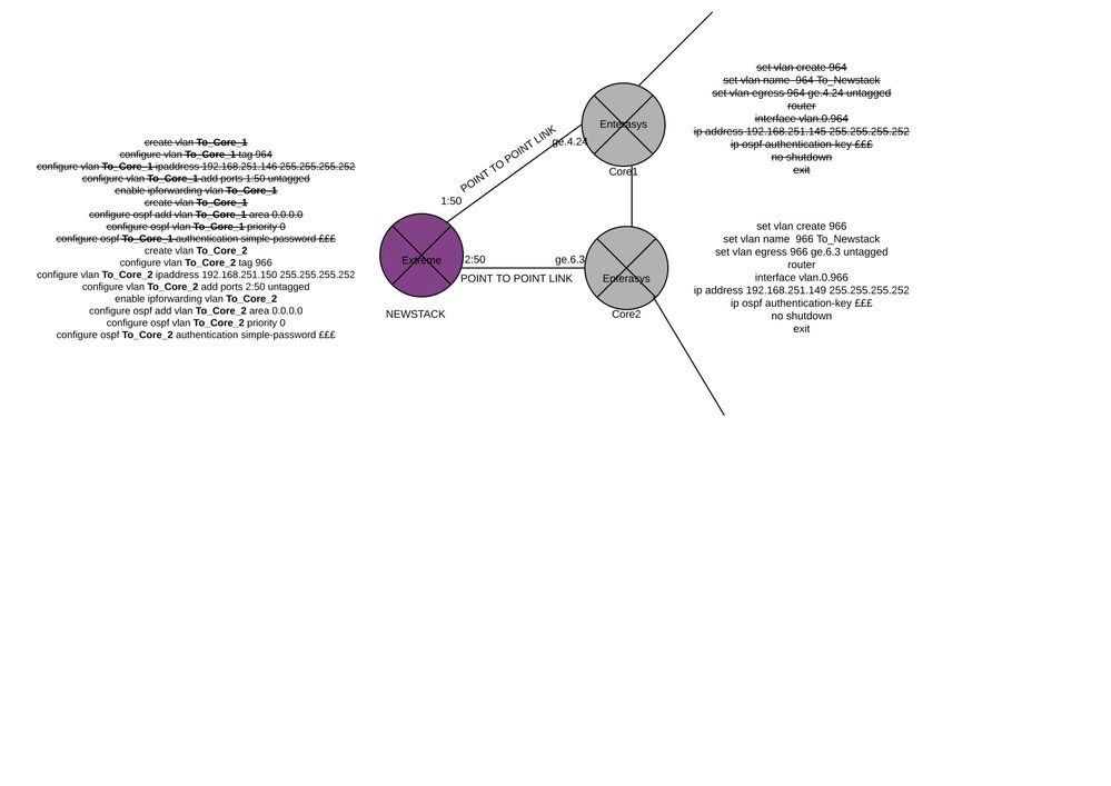

Hello all,
Currently trying to set up a secondary link from one of our edge devices back into our core. The core is running OSPF and the primary link works fine via OSPF, while trying to bring up the secondary link it seems to be getting stuck in the INIT state. The 2 core switches are enterasys S8 chassisā€™ with the whole of our network in area 0. The new edge device is a stack of x460 G2s. Attached is a diagram I put together, config with a line through it was previously implemented for the primary link, the config without the line through it is the newly added config. I appreciate I havenā€™t given all the information here but just wanted to check Iā€™m not missing anything major or going against any OSPF rules. My next step is going to bounce the vlan and physical interface. Also, we have a default route pointing towards the primary link (maybe a secondary route needs to point to the secondary link)
