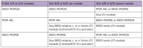

‎06-26-2017 12:13 AM
TaeYoung,
BlackDiamond 8810 switch
Slots 1, 2, 3, 4, 7, 8, 9, and 10 can accommodate only I/O modules.
Slot 5/A can accommodate only an MSM
Slot 6/B can accommodate only an MSM, with the exception noted in Table below:-
8806 switch
Slots 1, 2, 5, and 6 can accommodate only I/O modules.
Slot 3/A can accommodate only an MSM.
Slot 4/B can accommodate only an MSM, with the exception noted in Table below:-
8806 switch
