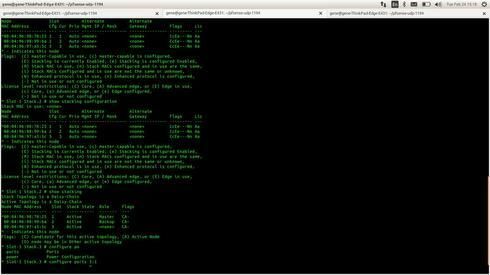

Gene_Fontanilla
As you can see, slot 3 which is the x440 switch, can be seen in the stack topology but cannot be configured, and is unable to see the master node. causing it to be stuck at AAA
Gene_Fontanilla
x670v switches have the same partition settings, i think x440 has different partition.

will attach screenshots
