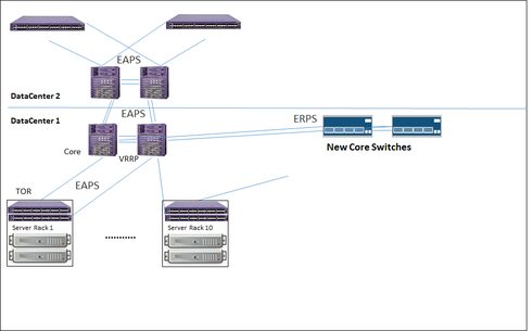

Ken_Johnathan
hi P,
i think it is feasible if ERPs can be a sub-ring of EAPs as below:
Step 1: Remove 1 uplink from TOR
Step 2: Disable EAPs on TOR (as no longer a loop at that moment
4df67c9f16854c04af95ce3fdec52963_RackMultipart20141022-11394-1r8wnk1-Step3_inline.png
Step 3:
I think it is doable. Pls comment. thx.
The new core is X8 but we wanna replace EAPs with ERPs through this exercise. thx.
