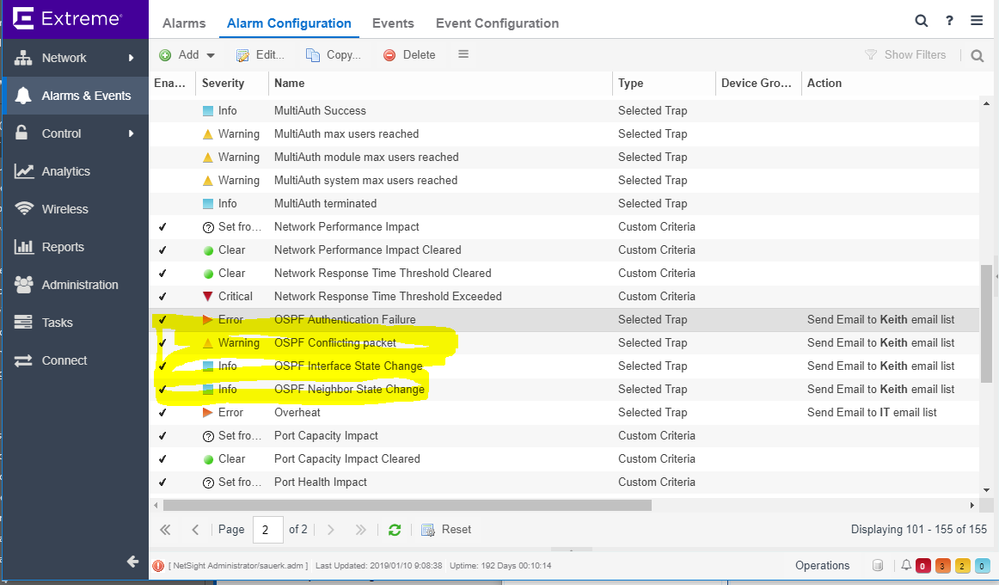

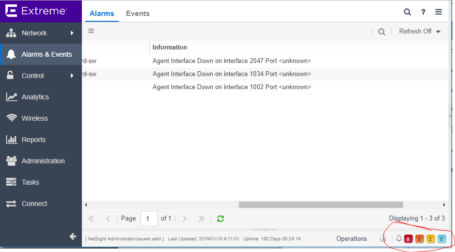

I'm attaching two screen shots to visualize in netsight what I'm looking at. In the lower right corner there are colored blocks by severity. I would expect the OSPF messages to end up in here like other messages do.
I would also expect the events to email me as a test due to the alarm configuration. I know that when we first migrated to X690's in the core, our consultant helped setup so if a power supply or fan goes, we do get alerted. That works as we tested pulling a fan or power supply briefly to check the logs and alerts.
This is on the switch side and the netsight server is in fact 10.1.0.110.

I have this configured in netsight to email me, but after hours yesterday I intentianally broke a link to generate a log to see if I would be alerted. The log generated on the X690 switch as seen in the sh log command, but in Netsight in the warning, info, error or critical sections that are notated and accessed from the lower right of the screen did not show anything excpet for common port up and port down messages for various things. Plus I was not emailed.
