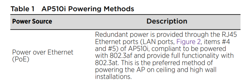

Here is a small update:
The GTAC confirms the different statements in the documents and will clarify them with the product management.
11-16-2020 06:24 AM
Strange indeed,
in addition on the product page:
https://www.extremenetworks.com/product/ap510ie/
There is a hint regarding redundant poe (search for redundant on the web page).
I have opened a GTAC case and will write here what comes out of it.
11-15-2020 11:24 PM
Good to know. I checked the tech specs before and there it is written:
Interfaces•
(1) 100/1000/2500/5000 Mbps auto-negotiation Ethernet port, RJ45 PoE (Power over Ethernet 802.3at) Port. (802.3bz supported)•
(1) 10/100/1000 Mbps auto-negotiation Ethernet port, RJ45
Only for one of the two interfaces PoE is listed. Strange.

I have not tried it, but according to the Quick Reference Guide for AP510Ie you can provide redundant power via both ethernet ports:

the APs I checked support PoE only on one of the interfaces, so the backup port doesn’t really help, since the AP will be powered off. Or do I miss something?
