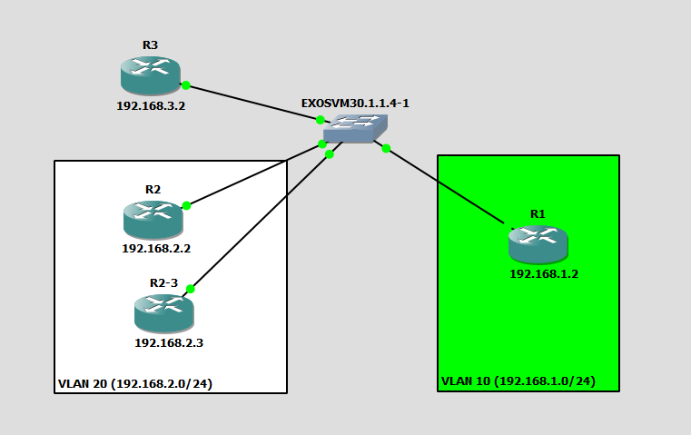

Here is my topology, I am using a router to act as host, since I do not have any host on my GNS3 lab
Topology

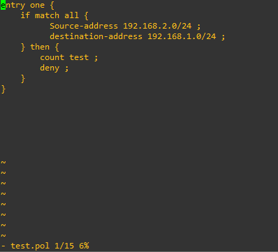

Policy created:
entry one {
    if match all {
          Source-address 192.168.2.0/24 ;
          destination-address 192.168.1.0/24 ;
    } then {
        count test ;
        deny ;

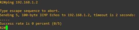

  • I apply the policy to vlan10 ingress direction, but both router from vlan20 can still ping 192.168.1.2 router.

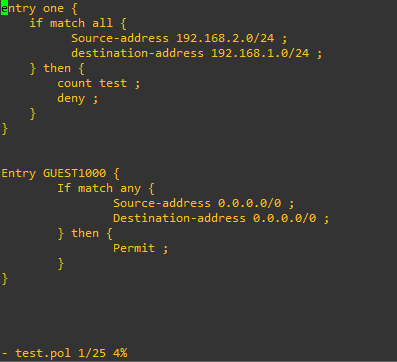

Scenario 2:
Objectives:
-VLAN 10 to deny all traffic coming from VLAN 20 (working)
-VLAN 20  to allow all traffic coming from VLAN 10 (not working)
Scenario:
  • I apply the policy to vlan20 ingress direction, and the ping was block, the problem now is vlan10 cannot ping vlan20 (even if I made a wildcard rule policy on the end.)
ACL workaround 2
Extreme Policy
vlan 2 to vlan 1
vlan 1 to vlan 2

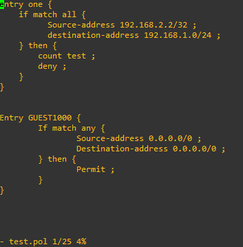

-VLAN 10  to deny only 1 IP from VLAN 20
Scenario:
  • I apply the policy to vlan20 ingress direction.
  • vlan10 blocking the whole vlan20 subnet
Policy
Router 2.2 (working)
Router 2.3 (not working)
