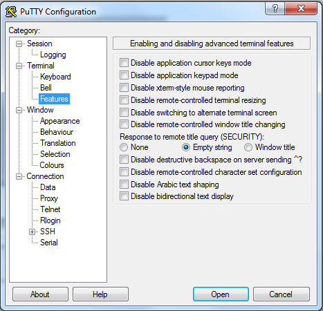

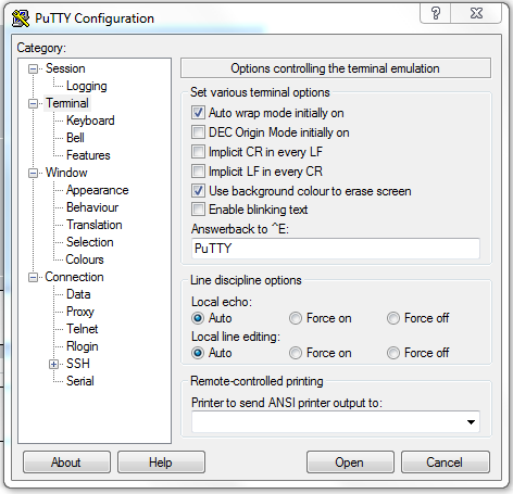

‎10-26-2016 06:00 PM
I remember to have experienced once or twice that issue on telnet/ssh as well. What terminal emulation are you using? (not the program, but the settings).
I do not use Putty, but I was hoping to find some terminal emulation parameters. In SecureCRT I use VT100, and I barely have issues with telnet/ssh.
Here my settings:
