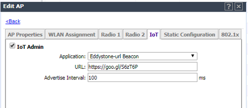

Here what XMC is sending:
e53d23ebaae342539cc329e0321b5d1a.pngMig
