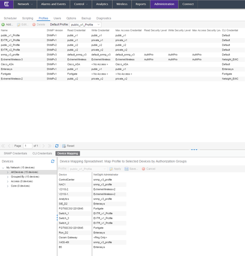

Check in EMC if both are set to the same profile in device mapping (lower part of the screen) ...
060f9e3b7c2b46cf81b29533db1681eb_RackMultipart20170209-749-os2mq0-EMC_SNMP_device_mapping_inline.png
