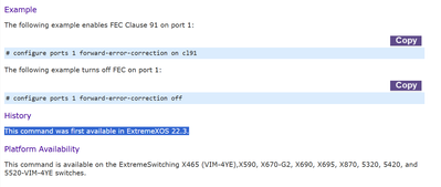

4 weeks ago
It need to work on ExtremeXOS 22.3 and the above.
This command was first available in ExtremeXOS 22.3.
