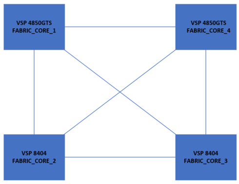

Some more fabric questions from my Fabric lab.
I have the following setup:

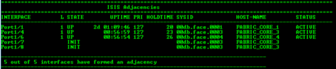

If I look at the ISIS adjacencies I see that all the adjacencies are active and working:
Core 1:
64d10e9f5b544cb4ac0ee5e9e5c56377_RackMultipart20181101-64934-1y4i2nh-Adj_1_inline.png

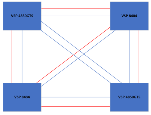

I now add additional redundant links and have a look at the adjacencies again.
64d10e9f5b544cb4ac0ee5e9e5c56377_RackMultipart20181101-3902-1sckd2h-Diagram_2_inline.png

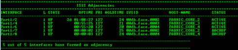

Redundant links to or from the VSP 4850's to either another VSP 4850 or VSP 8404 is added to the list but in a backup state. This is expected.

However backup links between the two VSP 8404 nevers passes the INIT state
64d10e9f5b544cb4ac0ee5e9e5c56377_RackMultipart20181101-72714-1bode74-Diagram_4_inline.png
When I remove the primary links the links that was stuck in "INIT" moves to active.
Both the 48xx and 84xx is running the same code.
Why does the 84xx not move to backup?
