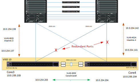

So had another idea (to try and keep it simple), but not sure if anyone can collaborate it - but basically to use software port redundancy instead:
https://extremeportal.force.com/ExtrArticleDetail?an=000081265
Take the following:
4d6d905edcb54851949eae4ff364d3a7_RackMultipart20170823-6836-1y8filo-Floating-Route2_inline.png
So here I have removed the LAG / Port-Channels between the Extreme and Cisco's. Each Extreme core has a default route configured to their respective Cisco core, and the software redundancy will take care of activating or re-activating the redundant links. Routes shared via OSPF between the Extreme cores would then handle where to direct traffic dependant on whether to links to legacy core 1 or legacy core 2 go down?
What do you think?
