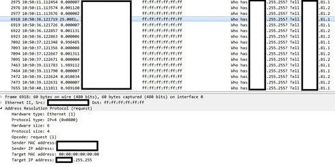

Frequent ARP request broadcast for Who has x.x.255.255? from S-Series root switch in RSTP VLAN
04-21-2016 01:25 PM
We are getting average of 1 pps and peaks of 60 pps of these packets, from Wireshark trace.
Please kindly share information on what is the cause of these broadcasts and how to minimize the frequency.
TIA.
Screenshots of Wireshark decode and IO graph below:

14 REPLIES 14
