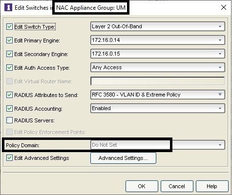

I can't find out how to add X690 to policy domain. XMC throws out the popup window "The devices listed below were identified as Not Supported and will not be added to the domain."

I can ad switch to console, i can add switch to netsight but whitout assigne it to Doman Policy, and i can't add switch to Domain Policy through Java app - Netsight Policy Manager
I have 4 of those in 2 stacks

is it possible to post a screenshot of the error message which you have mentioned before?
