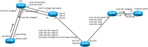

I have a setup as described below.
Today I have to use a MX80 for this purpose but I was wondering if there is anything I could do within a Extreme switch instead
To explain my predicament a bit further
The port called ge-1/1/9 towards something called Telia NNI is a VLAN 0x8100.
The port called ge-1/1/0 towards the L460 ( L is for Labb X460) is VMAN 0x9100
Vman tagged traffic is received ingress on port ge-1/1/0 with the tags specified ( 33,401,501,601)
Egress towards L440 on interface ge-1/1/9 we have to
translate 401 to 41
translate 501 to 51
translate 601 to 61
At the same time we have to innertag vlan 33 on all those translated vlans cause that vlan is the inbound managment on the left L150 called CPE.
The L440 ( out of my control and part of a provider network ) just have vlans tagged on egress towards the MX80 ge-1/1/9 and have no idea of the vlan tags we sent from the L460 ( 401,501,601) so the only thing it can see ingress is the vlan tag 41, 51, 61 and NOT 33 cause that tag is not part of the NNI interface.
The switch Im' trying to do this is can be of whatever model there is from extreme x670 to x440. But I have yet to figure out if this is doable on any switch ?

1d032db0ece045ebb5e4444c81688c1f_RackMultipart20150316-22220-1egvegz-setup_inline.png

Hello, Andreas!
I think you mean Selective Q-in-Q in Extreme switches.
