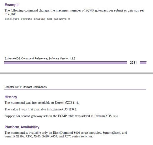

ECMP is supported on EXOS 12.6 but it is not supported on the 10K.
‎10-27-2015 02:40 PM
Many Thanks , just unsure it was supported with the old code and no configuration notes.
‎10-27-2015 02:36 PM
yep,
enable iproute sharing
configure iproute sharing max-gateways (default 4)
