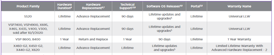

Please see:
“Lifetime updates and upgrades”
FYI, I’ve sucessfully downloaded few .xos files varying between 22.7 - 31.2 without any issue. I don’t own any support contract for any of my gear.

Hi Tomasz,
don’t they have limited lifetime warranty (LLW)?
An LLW will cover security patches and minor fixes, but you don’t get updates or upgrades.
TBH I don’t know what this means for EXOS. Is 30.6 → 30.7 a update that is covered by LLW? Or only from 30.6.1 to 30.6.2?

As far as I remember X440-G2 has a lifetime warranty with software updates and upgrades covered without a contract.
https://www.extremenetworks.com/support/policies/
Hope that helps,
Tomasz

thank you very much for your answer. Unfortunately the two aggregation switches do not support MLAG as far as I know (these are Ubiquiti ES-16-XG).
And how do I get software updates for the X400-G2? Do I need to buy a support contract?
