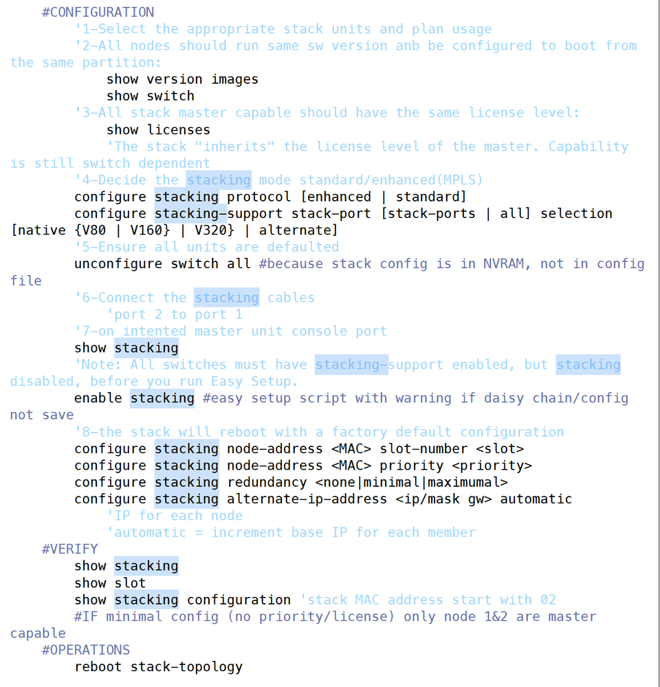

10-25-2020 04:27 PM
jveronese,
Please review the stacking steps.
Here the steps from my cheat sheet:
Mig

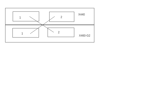

10-25-2020 04:21 PM
Sorry, I’m new to stacking, so I do not know how to tell if it is STP or EAPS.
This is a rough drawing of what I have. Stacking port 1 on 440 is going to port 2 on the 460, with port 1 on the 460 going to port 2 on the 440.
10-25-2020 04:06 PM
jveronese,
Something i not clear.
Are they in stacking or ring (STP or EAPS)?
A topology drawing could hep to understand
