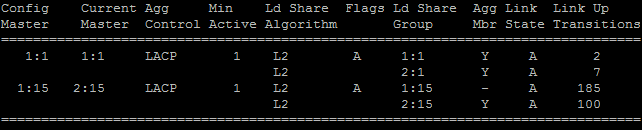

Hi Team,
i have configured the lacp with group id 1:15 and i have also configured the fallback on LAG 1:15 for PXE server ,but after the intializing of server the port 1:15  get aggregated but after getting the ip to the pxe server the state changed and 2:15 get aggregated instead of port 1:15 , i just want that the port 1:15 should get aggregated. below are the log messages.
A total of 10 log messages were displayed. * Slot-1 SW-D16.141 # sh log 12/06/2019 10:25:54.78 <Info:vlan.msgs.portLinkStateUp> Slot-1: Port 1:15 link UP at speed 10 Gbps and full-duplex 12/06/2019 10:25:50.21 <Info:LACP.AddPortToAggr> Slot-1: Add port 2:15 to aggregator 12/06/2019 10:25:49.10 <Info:vlan.msgs.portLinkStateDown> Slot-1: Port 1:15 link down - Local fault 12/06/2019 10:25:48.24 <Info:vlan.msgs.portLinkStateUp> Slot-1: Port 1:15 link UP at speed 10 Gbps and full-duplex 12/06/2019 10:25:48.17 <Info:LACP.SlctFallbkPortDone> Slot-1: Port 2:15 has been selected as fallback port. 12/06/2019 10:25:48.17 <Info:LACP.RemPortFromAggr> Slot-1: Remove port 1:15 from aggregator 12/06/2019 10:25:48.16 <Info:vlan.dbg.info> Slot-1: Port 1:15 is Down, remove from aggregator 1:15 12/06/2019 10:25:48.16 <Info:vlan.msgs.portLinkStateDown> Slot-1: Port 1:15 link down - remote fault 12/06/2019 10:25:07.80 <Info:LACP.AddPortToAggr> Slot-1: Add port 1:15 to aggregator 12/06/2019 10:25:05.78 <Info:LACP.SlctFallbkPortDone> Slot-1: Port 1:15 has been selected as fallback port. A total of 10 log messages were displayed.
