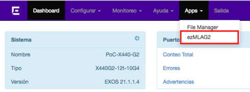

dflouret
Ian,
One of the hidden goodies of v21.1.x is that you have an application in the GUI to automate the configuration of MLAG.
It is documented in the Chalet User Guide
http://documentation.extremenetworks.com/chalet/index.html
You may want to play with it and tell us what you think about it.
