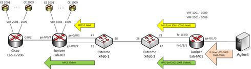

Here is lab network to test balancing on client ports on Extreme Network switches (X460 in lab, but we have the same problem with X670-G2 in production).
We are interested in sharing group 21 (ports 21, 22) on X460-1.
From Agilent (IP tester) IP traffic goes to Lab-M01 to 18 different VRFs (1001-1009 and 2001-2009). Lab-M01 sends out traffic in VRF 1001 through 1009 with one MPLS label, in VRF 2001 through 2009 with two MPLS labels. When we configure X460-1 and X460-2 as simple L2 switches with one vlan from sharing group 21 on X460-1 to sharing group 21 on X460-2, then balancing works.

The problem is that when we configure VPLS on X460-1 and X460-2 to pass the same traffic balancing stops working. All traffic goes to one port (either 21 or 22 depending...).
What can we do to make balancing work with VPLS?
