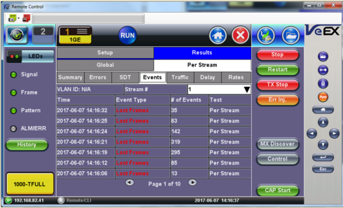

I have a domain eaps , and i did a test for a frame size 64 bytes , for the primary port the test is sucefull but when did a fail over at the secondary port test no pass.
I have configure jumbo frame , can you share the possibilities for this scenery ?

This is the capture of errors

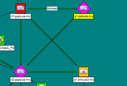

Yes , i have the fallowing configuration
* a1-jade-ps-mx.1 # show eaps "eaps-perisur"
Name: eaps-perisur Priority: Normal
State: Complete Running: Yes
Enabled: Yes Mode: Master
Primary port: 28 Port status: Up Tag status: Tagged
Secondary port: 26 Port status: Blocked Tag status: Tagged
Hello Egress Port: Primary
Hello timer interval: 10 sec 0 millisec
Fail timer interval: 30 sec 0 millisec
26 d1-ppps-ps-mx 00:00:00:04:96:35:d3:99 1:48 19 14
28 d2-ppps-ps-mx 00:00:00:04:96:35:d3:4c 1:47 14 14
* a1-jade-ps-mx.3 #
* d1-ppps-ps-mx.1 # show eaps "eaps-perisur"
State: Links-Up Running: Yes
Enabled: Yes Mode: Transit
Primary port: 49 Port status: Up Tag status: Tagged
Secondary port: 48 Port status: Up Tag status: Tagged
Preforwarding Timer interval: 15 sec
Last update: From Master Id 00:04:96:97:dd:c6, at Thu Jun 15 15:24:14 2017
48 a1-jade-ps-mx 00:00:00:04:96:97:dd:c6 1:26 56 14
49 d2-ppps-ps-mx 00:00:00:04:96:35:d3:4c 1:49 8 218
d2-ppps-ps-mx.1 # show eaps "eaps-perisur"
Primary port: 47 Port status: Up Tag status: Tagged
Secondary port: 49 Port status: Up Tag status: Tagged
The situation is when change the path for the secondary port (fail over) the test that ran fail. Exactly with frames 64 bytes - 350 bytes
I saw a congestion over the neighbors port but for the route primary (a1-jade - d2-ppps-d1-ppps) is the same behavior and the test dont have errors (frames loss)
* a1-jade-ps-mx.3 #
