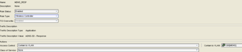

Hello, I have currently setting up mdns to work on our network. I currently have full netlogin enabled on the wired side. I have one policy domain for the wireless and wired. My issue is i have everything setup on the mdns side to contain to a specific mdns only vlan. However i also have wired clients that i would like to see the mdns requests. The wireless and wired vlans are separate. My core is a K-series and everything else is on the X-460-G2 platform. When i try to configure this for the wired side the same as the wireless side. there is no "contain to vlan" for a rule on the "X450G2/460g2/670g2/770/870" specific rule type is there some sort of acl that i can setup that will forward all the mdns traffic on the wired vlan to the mdns vlan also?

I want to also add that the mdns vlan is bridge at ap and my main vns egress is bridge at ewc. the mdns vlan is added as tagged for the ap's though netlogin.
