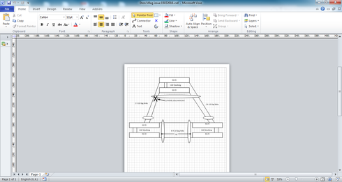

						I have now been to site and the actual issue seen is different to that originally described by myself.
This is basically a traditional mlag using 3 sets of X670 ( 2 x stack ) 8 x 10 Gig connection between the mlag peers and 2 X 10 Gig conenctions from each peer to the stacked X670 edge.
This is running 15.5.5.2 code due to a bug giving igmpv3 issues , we have already tried upgrading to 15.6.3.1-patch1-9 , though this just returned us to the original reason for needing the bug fix 15.5.5.2
Basically when they are having issues , ie cannot use the network ( though not everyone is effected they remove on of the peer uplinks and it all works
Currently they have disconnected 2 links as in diagram above
