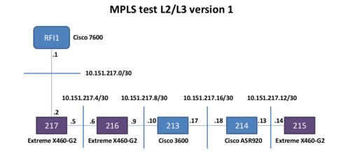

Here are the L1 and L2/L3 schemes of version 1 of my lab ...
On each switch/router we have 2 loopback interfaces/vlans:
- 1 for OSPF 172.18.0.x/32
- 1 for iBGP 172.18.128.x/32
The «x» refers to the numeric ID of each switch/router, with the only exception of RFI1, where:
- OSPF loopback is 172.18.0.3/32
- iBGP loopback is 172.18.128.1/32
All switches are in the same OSPF area 172.18.128.217, and is the BGP AS 172. RFI1 is the RR for the BGP part, and the ONLY neighbor for each switch/router.
All ospf interfaces are PTP.

To be more specific, if we look at «version 1» of the test, if we try to ping from RFI1 using the iBGP loopback interface as source, and the iBGP
loopback interface of each other switch/router as the destination, we have:
- RFI1 can ping 217
- RFI1 can ping 216
- RFI1 CANNOT ping 213
- RFI1 CANNOT ping 214
- RFI1 CANNOT ping 215

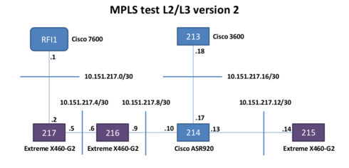

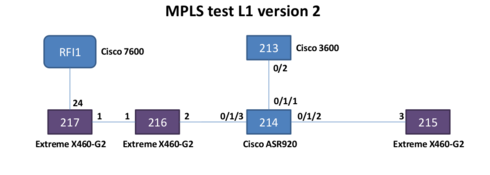

Here are pictures for version 2 of the same lab ... same results ...
