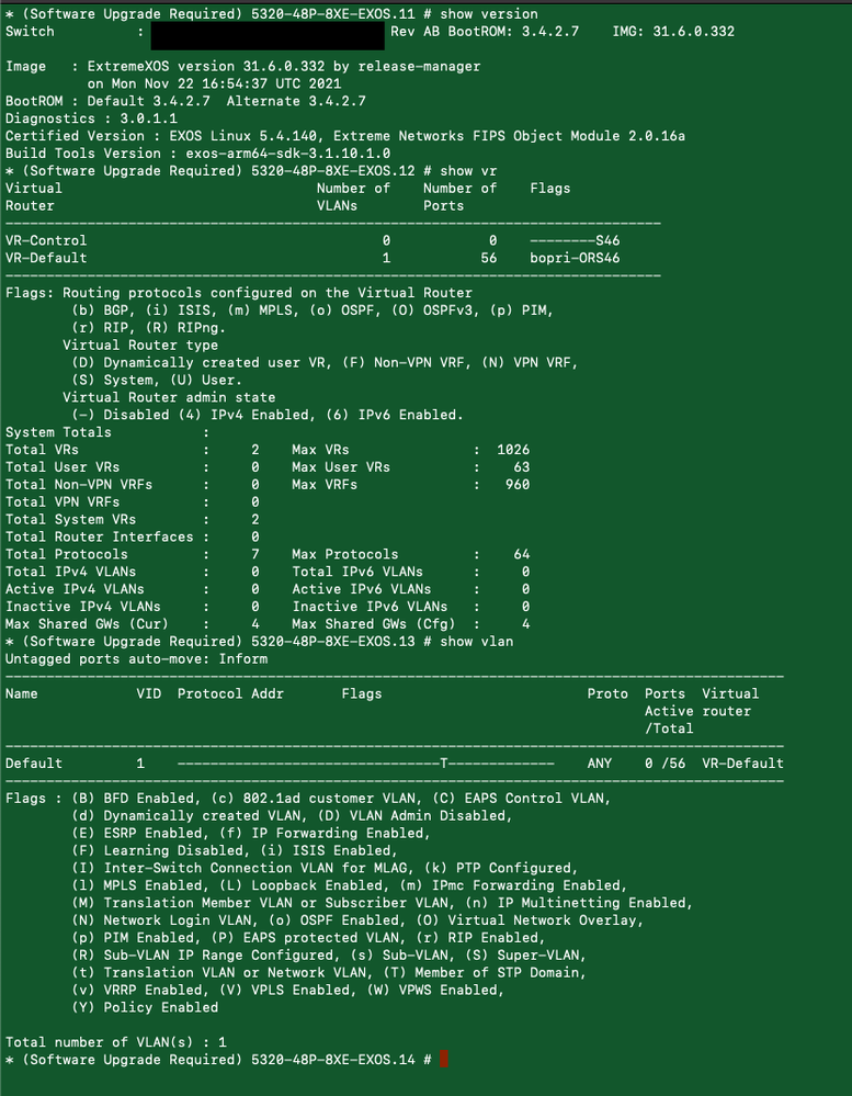

We just unpacked some of our new 5320s, and as part of our configuration, we set the IP for the Mgmt VLAN.  However VR-Mgmt (and therefore VLAN Mgmt) is missing...

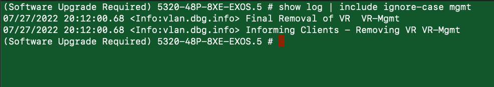

And found this in the log on boot:
The screenshots above are from a straight out of the box switch, hence the Software Upgrade Required message, but we've also updated a stack to 31.7.1.4 and still the same.
We're obviously probably doing something wrong or missing something, but can someone point me in the right direction?
