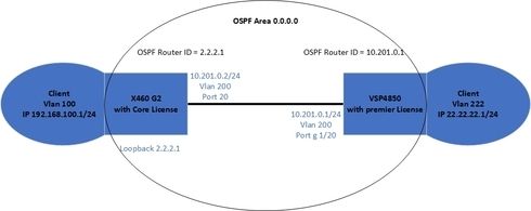

In my Lab I am trying to configure OSPF routing between a x460-G2 and a VSP4850.
The x460-g2 is loaded with a core license and the VSP4850 is loaded with the premier license.
The network diagram looks as follows:
I have a client vlan create on the x460 and another client vlan on the VSP4850.

The questions is what should the OSPF config on the VSP side be then?
