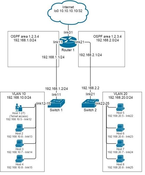

I have changed the network topology, but it is basically the same settings, and the problem is the same even in this setup. I tried with Windows-host and with Switch that acts as a host. I can ping from one host to another's default gateway, but can't reach the host.
b3440fa208854abbb3f5579191d02f27_RackMultipart20150416-4384-1dsx2sz-network_topology_inline.jpg
