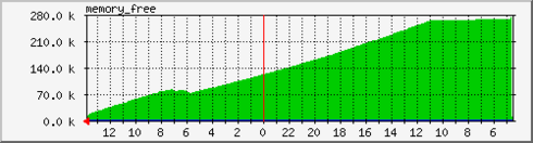

Everyday we have trouble with our extrereme x480( ExtremeXOS version 15.5.2.9 v1552b9-patch1-5 by release-manager ). Memory at device to decreases to zero and rebooting.

That meant you were storing the routes into memory. x480 is capable to store up to 512k routes in hardware (more with compression enabled), but you have to configure the switch for that. The default is L2-and-L3, with 256k each. You were above that threshold.

I found what the problem is.
after write command:
configure iproute reserved-entries maximum
