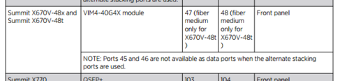

Well I believe I have figured it out. I cannot do what I am wanting to do. According to the SummitStack-V documentation on a x670V-48t only the fiber modules can be used as stacking ports and ports 45 and 46 cannot be used at all. Well that throws a wrench in my plans, my 450a 10GbE module has copper ports.......... PIA
