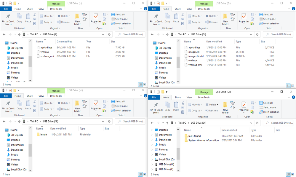

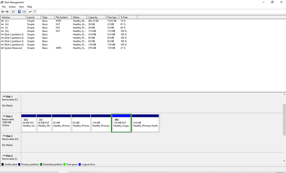

So I bought an Extreme Networks Summit X460-48P PoE switch for just under 20 bucks and I am struggling to get it to work. I contacted the agency I purchased it from and they said it worked fine, they just factory reset it. Here is what I've done:

Plugged in the CompactFlash into a computer and taken screenshots. (attached)
Removed the compact flash card and powered it on and I get different lights blinking than normal.
