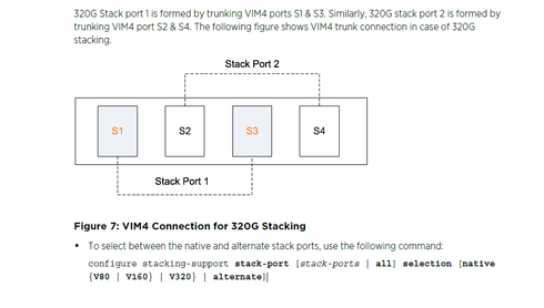

V320 stacking on an X670V involves using all the slots on the VIM4-40G4X. As mentioned in the earlier posts, slot 1 and slot 3 are paired physical ports and act as stack port 1 on the VIM. Likewise, slot 2 and slot 4 are paired and act as stack port 2. Slot 1 on one switch will always go to slot 2 on the other switch and slot 3 on one switch will always go to slot 4 on another switch. This is a simplified example of how the physical connections should be set up in a three node V320 stack.
![cb0ae03e58e74454a8f841443a09a728_RackMultipart20141204-31038-93vum0-V320_inline.png cb0ae03e58e74454a8f841443a09a728_RackMultipart20141204-31038-93vum0-V320_inline.png](/t5/image/serverpage/image-id/3284i916B38E948AA18D2/image-size/large?v=v2&px=999)
