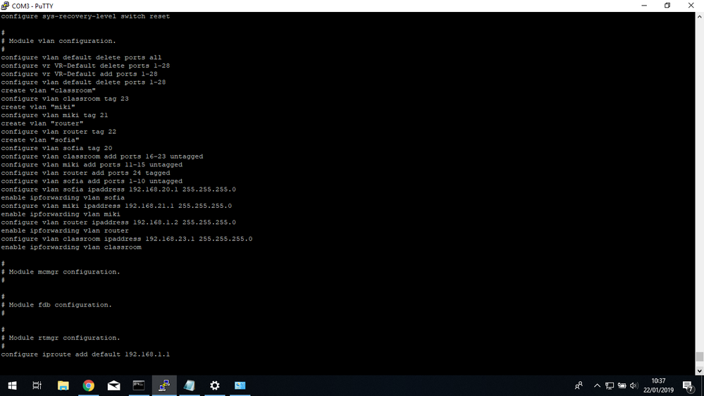

We have configured the switch with the option you told us. I attached screen to you to see it.
Two things happen to us.
1Āŗ We still do not have internet in any of the vlan
2Āŗ We do ping between vlan, when we do not want that.
Thank you
regards

I don't have any EXOS right now in front of me but let's try two approaches:
A. Your switch is just to pass VLANs to Mikrotik which will route between VLANs and WAN by itself:
code:
create vlan sofia tag 20
create vlan miki tag 21
create vlan router tag 22 #?
create vlan classroom tag 23
conf def del po all
conf sofia add port 24 tag
conf sofia add port 1-10
conf miki add port 24 tag
conf miki add port 11-15
conf router add port 24 tag
conf class add port 24 tag
conf class add port 16-23
With this, your router should have VLANs 20-23 created and routing for them as well. And your VLANs shall not use the same subnet.
B. Your switch is a router between VLANs and Mikrotik ultimate gateway
code:
conf def del po all
conf sofia ip 192.168.20.1/24
conf miki ip 192.168.21.1/24
conf router ip 192.168.1.2/24 #assuming Mikrotik is 192.168.1.1 or else?
conf class ip 192.168.23.1/24
enable ipforwarding
conf iproute add default 192.168.1.1
Take care about potential security issues, without any ACLs or Policy those VLANs will be able to talk on L3.
Hope that helps,
Tomasz
