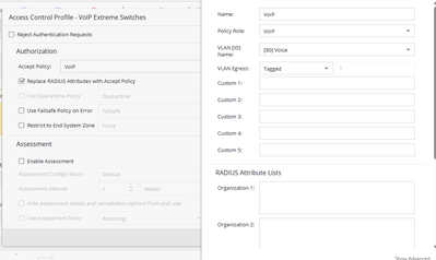

On the XIQ
The port is configured as a trunk and auto-sense is disabled on the ports. VOIP VLAN is 80.
