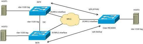

We have two X670 with MLAG and MPLS/VPLS enabled, some ports use MLAG. We have shared group of 4 ports for ISC link between switches, also have customer vlan V100 on both switches, vlan V100 does not added to any MLAG ports, only to ISC link as tagged and one non-MLAG port on each switch as tagged. On each switch have vpls pw to same destination(cisco). This PW-res using V100 as service vlan. One VPLS on one switch have status UP, another VPLS on another switch have status STANDBY because they both connected to the same Cisco ME3600X with "xconnect" and "backup peer" config.
Problem:
In FDB we don't see any MACs on ISC link and traffic flooded to all ports belonging vlan V100 because switch don't have destination MAC in FDB. If we remove one of vpls pw-res MACs appear in FDB as Software Controlled Deletion on ISC link and all work correctly on switch where not have vpls pw. Disabling vpls is not help only deletion. Version IMG: 16.2.2.4.

Thank you. We have solved it by creating different link between x670s for VPLS vlans. Now we have one ISC link and one "ISC for vpls".

I do not know if you've solved, I had similar problems in the past with Pe 670 with mpls / vpls and mlag configured at the same time, you need to use a dedicated link to vlan Isc, after you see that the fdb is populated correctly. And everything will work fine.
See the user manual in section of Mlag limitation and requirements. (ex. in xos16.1 page 293)
MPLS:VPLS VPLS must be configured for redundancy using ESRP. The ESRP master VLAN must include the ISC ports and the VPLS service VLAN ports as members.
Pseudowires cannot traverse an ISC link. You should not add the ISC port as a member to MPLS VLANs that can be used by LSPs that can carry Layer 2 VPN traffic terminating on MLAG peer switches.Loris
