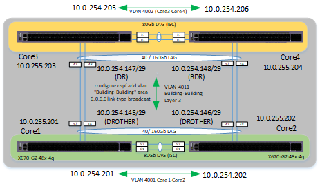

Interestingly I am currently experiencing an issue that I think Erik is describing. Was running version 21.1 and now 22.4.
Here is a very high level overview of the network:
If Core 1 is rebooted whilst pinging Core 3 & Core 4 there is 7 dropped pings before service is restored, but pinging a device that hangs off Core 1 & Core 2, say a LAG'ed Switch or a PC hanging off it, its fine.
If Core 2 is rebooted for exactly the same scenario only one ping is dropped in each case.
Below are some observations I made:

Each core pair is running MLAG, as shown by the ISC link. The two cores are connected via a common LAG, and OSPF broadcast is configured between them with Core 1 as the DR and Core 2 the BDR.
VRRP is configured so that there is a common VRID between all four switches, for each of the common VLANs that exist between them all. There is also a VRID for VLANs that only exit on one pair, and another VRID for the VLANs that exist on the other. Fabric routing mode is enabled on all the VRRP instances.
What I think I am seeing is what Erik is describing, in that there is some delay, perhaps related to learning new routes (in relation to OSPF) before things normalise and what is causing this 7 second delay.
Pretty sure the same thing is happing when doing the same test on Core 3 and Core 4.
