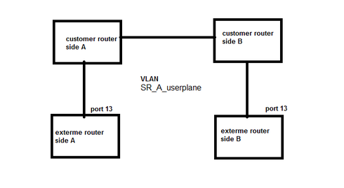

the VLAN SR_A is configured on port 13 and the connection towards our customer routers are like the attached.
Within redundancy tests we face the following scenario:
1- the problem is when router A restarts router B becomes master and handles the traffic and when side A comes into service it becomes backup and no pre-emption is done.
2-when we try to disconnect cable (to simulate cable fault) connecting exterme router side A to customer router side A , exterme side A becomes in INIT state and B become master. when the cable was returned again side A becomes master again and pre-emption happened which means double failover that not required.
