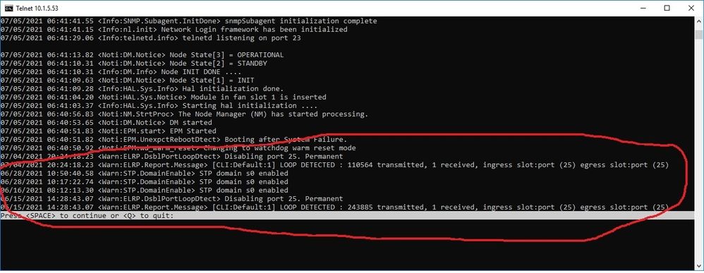

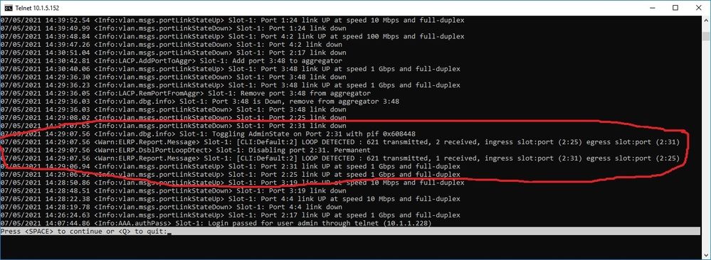

Who can explain this? Summit 440-g2. Elrp
Alexey_shaverne
you can see Normal operation of ELRP
you can see not normal ELRP
Why does this happen on all the trunk ports on a number of switches that are located in different branches of the star topology. When ELRP is enabled on these ports.

And what makes you think that the ELRP alert is wrong? There might be a loop somewhere on another Edge-Switch.
3 REPLIES 3
Stefan_K_
Valued Contributor
Alexey_shaverne
concentration switch (core)
Stefan_K_
Valued Contributor
What is connected on this Port (25)?
