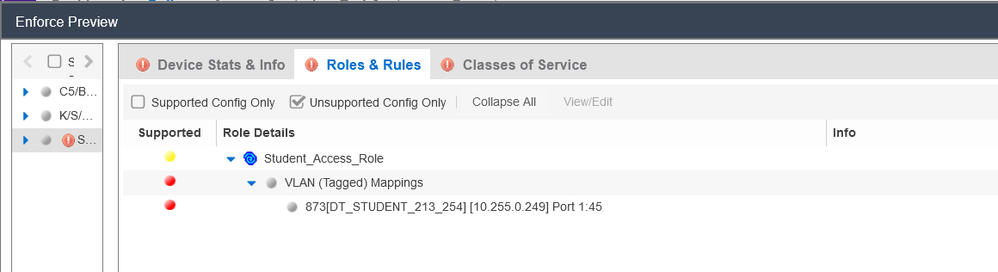

XMC 8.4.4.26 X670 22.7.1.2 Pushing policies and trying to map to a tagged vlan on a trunk port. With show config I can see the profiles and rules where pushed but the particular role was not attached to the port. This is working on “S”cores and “SSA’s. Is the screen shot below confirming that X670 does not support this or is there a latter version of code that does?
thnks in advance

We had similar issue with port-configs and summit-switches.
With EXOS 30.7 and XMC 8.5.4+ it works much smoother. If possible I would try updating. Otherwise I would get in contact with GTAC.

GTAC has confirmed that this functionality is missing when using the latest versions of code . They have issued a feature request 02403781 6/14.
