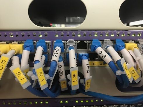

UTP is not connected but the green LED is blinking on the port.
Disabling a port will also mark the link status as active.
I have treated the equipment three times with the same symptoms, but I get the same symptoms.
I wonder how these symptoms come out and how to solve them.
In the picture below, ports 21 and 24 are not connected to the utp but a green LED
Coming in. If you disable port 21, the link is enabled as shown below.

Jeon, there were a few issues in the past in which X460 ports would go into a shutdown state, though the port would display Active and the LED would be green.
Looking into this there were two possible causes along with next actions:
1. Hardware - Please run extended diagnostics on the switch and verify whether any of the tests come back as failed. Also confirm whether the symptoms return after the reboot.
2. Software - As mentioned above, there was a rare issue with the PHY in which the state would not change. This was resolved in EXOS 16.1. It would be recommended to upgrade to v16.2.2.4-patch1-3 and monitor the ports to see whether the issue returns.
Let us know if there are any questions.
