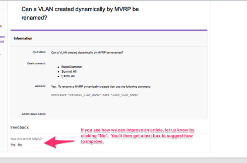

Hey Antonio,
Looks like Chad updated the GTAC Knowledge Article you just referenced and improved our KB by adding even more. Good stuff.
Did want to call out, that you can give us suggestions to improve articles directly on GTAC Knowledge. Here's a quick pic to show you how.
Just helps us keep straight your comments with which article. We'd love to hear from our customers on this stuff!
283264184b0d40bb97773219d342990e_RackMultipart20150611-28223-e5gv0-Q___A__Can_a_VLAN_created_dynamically_by_MVRP_be_renamed__inline.png
perfect, so please update the relevant documentation accordingly.
I think that it should be (more) clearly stated for example in this recent article
thank you
