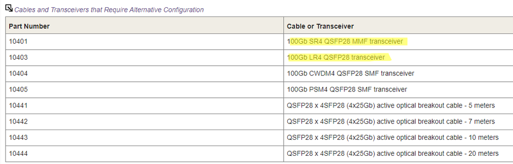

I would like to Stack two x690 using 100G QSFP28 (not DAC Cable). The reason is simple - I need to Stack them over greather distance (less than 10 KM) between two different Datacenters where I only have SingleMode connections.
I found different information in Extreme Documentations, thats why I would like confirmation from someone who did it.
https://documentation.extremenetworks.com/summit/GUID-CD79BCDB-A801-43F8-8A55-E7345FEAA6A9.shtml
 As we can see, there is no Max distance for the listed 100G GBIC.

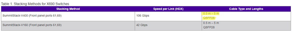

On the other hand, I found Extreme Documentations where it is stated only til 5 meters.
https://documentation.extremenetworks.com/extremeswitching/GUID-FEBCE99A-99FA-4AEA-A932-46A808CEEB2A...
