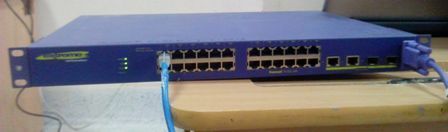

I have 8 Extreme X150-24t which have same problem. Not a single port of is working. I even tried console management but it showed some error message. Can anyone tell what is the problem with the switch.

Thanks for the reply. There is green blinking light in MGMT. Nothing is displayed when connected to console. There is no rebooting problem and no light in the all the ports. All the switches has same problem. I have attached the picture of one switch.
46689db71fa34b62be698f5865b7779d_RackMultipart20140301-19518-e3bhp0-switch_inline.jpg
