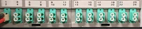

The fiber terminates on a LC patch panel in each room as can be seen below:

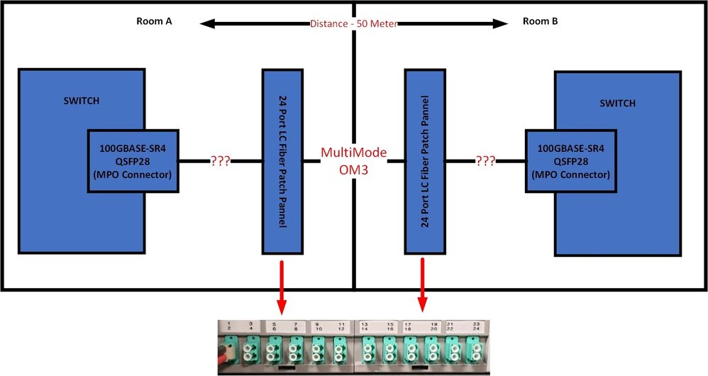

Below is an overview of what I am trying to do....
What cable do I use?
Can I use the above breakout cable on both sides?
