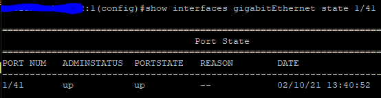

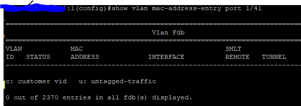

bfaltys
Contributor II
I’m new to these Extremes, but to me, this seems that the port is up and not learning any MACs…
