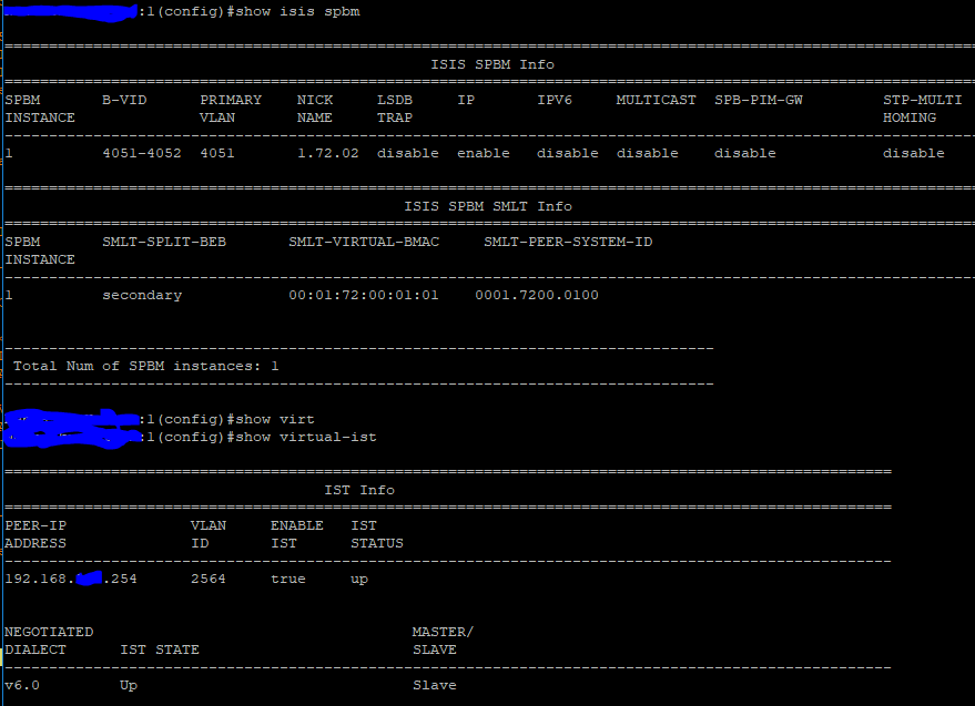

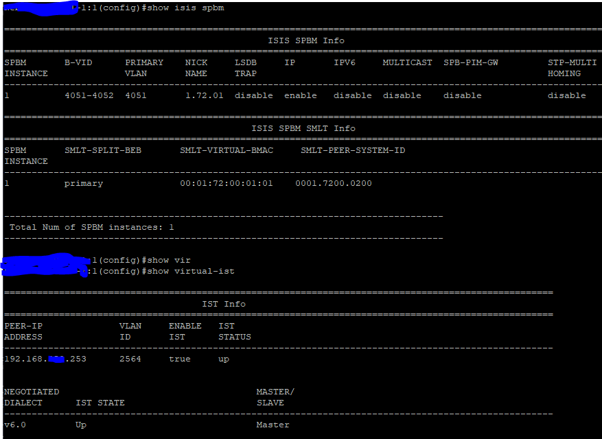

To be sure that all is ok on the mlt setup could oyu share:
show isis spbm
show virtual-ist
Mig

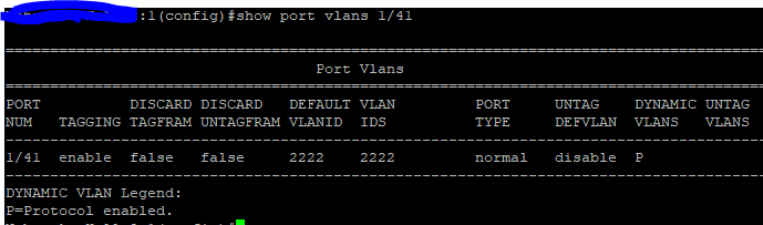

Could you share:
show port vlans 1/41
